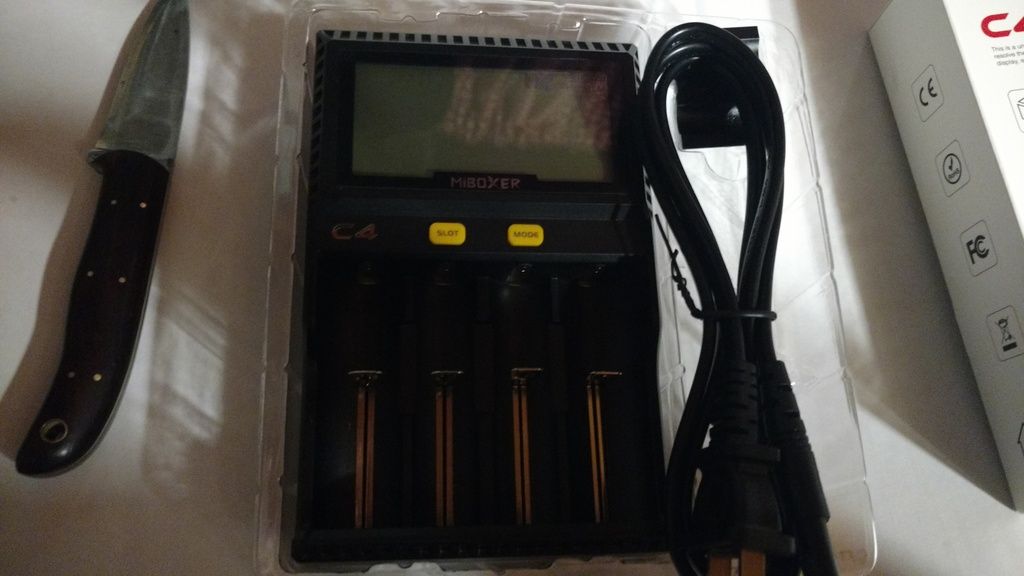

Ok in the box you get the charger, AC power cord (charger has built in PS so no wall wort just a standard two prong plug which can support from 86-265vAC) and a small cradle to help support AAA and smaller cells. Also comes with a small fold out pamphlet as a manual. The writing is quite small and can be difficult to read for some of the more experienced members of the forum.

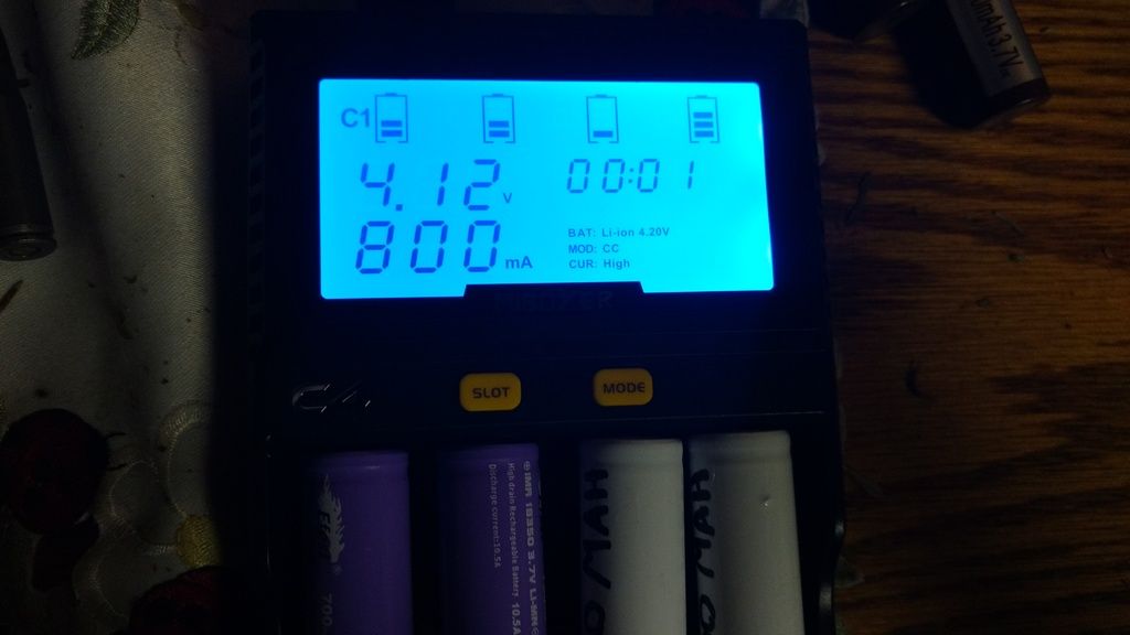

It supports 12DC PS as well but does not come with a cigarette lighter adaptor. Take a standard 12V laptop power supply or my hobby charger adaptor to hook to car battery so any lighter socket adaptor with that end on it should work fine.When you insert a cell it automatically detects whether its a lithium or nickel cell and after about ten seconds will start charging. At any time during the charge or before it starts pushing the mode button will toggle between current selection and battery chemistry. You can choose between 4.2V,4.35V, and 3.6V. Also you can choose between high and low current. For lithium cells high current is 800ma and low is 350ma. For Nickel cells high is 300ma and low is 150ma. The display will only show one slot at a time and gives voltage, current, and time. The far right slot will also do a charge/discharge/charge cycle. Discharge is at 400 or 200ma depending on your selection. Also as soon as you place battery in this slot it takes about ten seconds to do an internal resistance test. I'm not sure how accurate it is as it's not very consistent even with the same cell just by testing same cell multiple times.

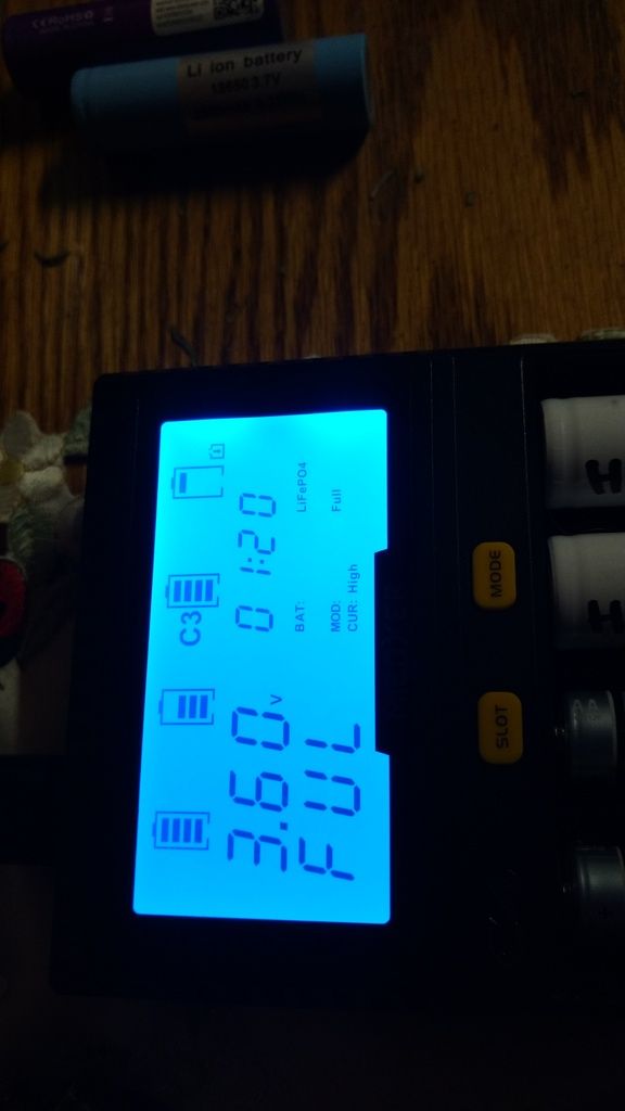

OK in use it works quite well for lithium charging. I charged a couple Efest 18350's a couple IMR 18650's, and 2 Lifepo4 18650's and the IMR cells all terminated at 4.19V. The lifepo4 cells came off at 3.6 and steadily dropped as they do.

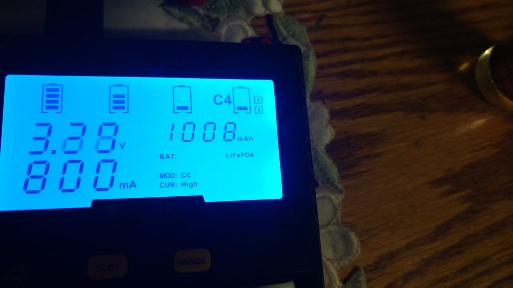

I did a charge/discharge/charge cycle on a lifepo4 cell. It charges at 800ma and discharges at 400ma. This only works in the right slot

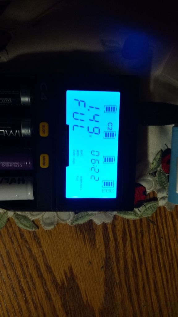

On NIMH cells I was able to charge 2 AA Maha Imedions at 300ma. They took 6H22m to charge and they went in at 1.2V.

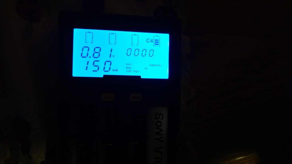

This charger has a built in "lithium battery restoration" which is for a deeply discharged cell and is supposed to bring the voltage up gently. I have a sony VTC6 which I found in a battery recycle box that was at 0V. So I gave it a try. It started the charge in NIMH mode at 150ma. Once the cell reached 1.6V it switched to li ion mode at 300ma. Once the cell reached 3.6V it switched to the full 800ma until CV part of the charge and finished normally. Don't get me wrong this cell is toast but it can do it and it uses quite gentle current steps to do it.
